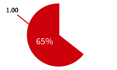

A project with a one-hour active installation time requires a labor unit of 1.54; 65% of 1.54 is 1.00.
