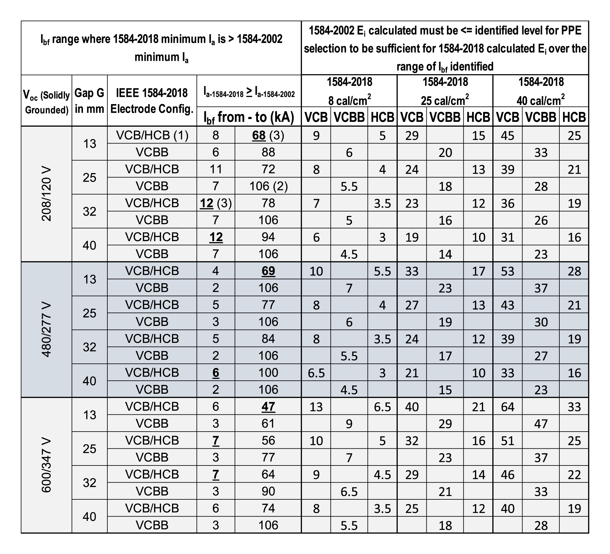

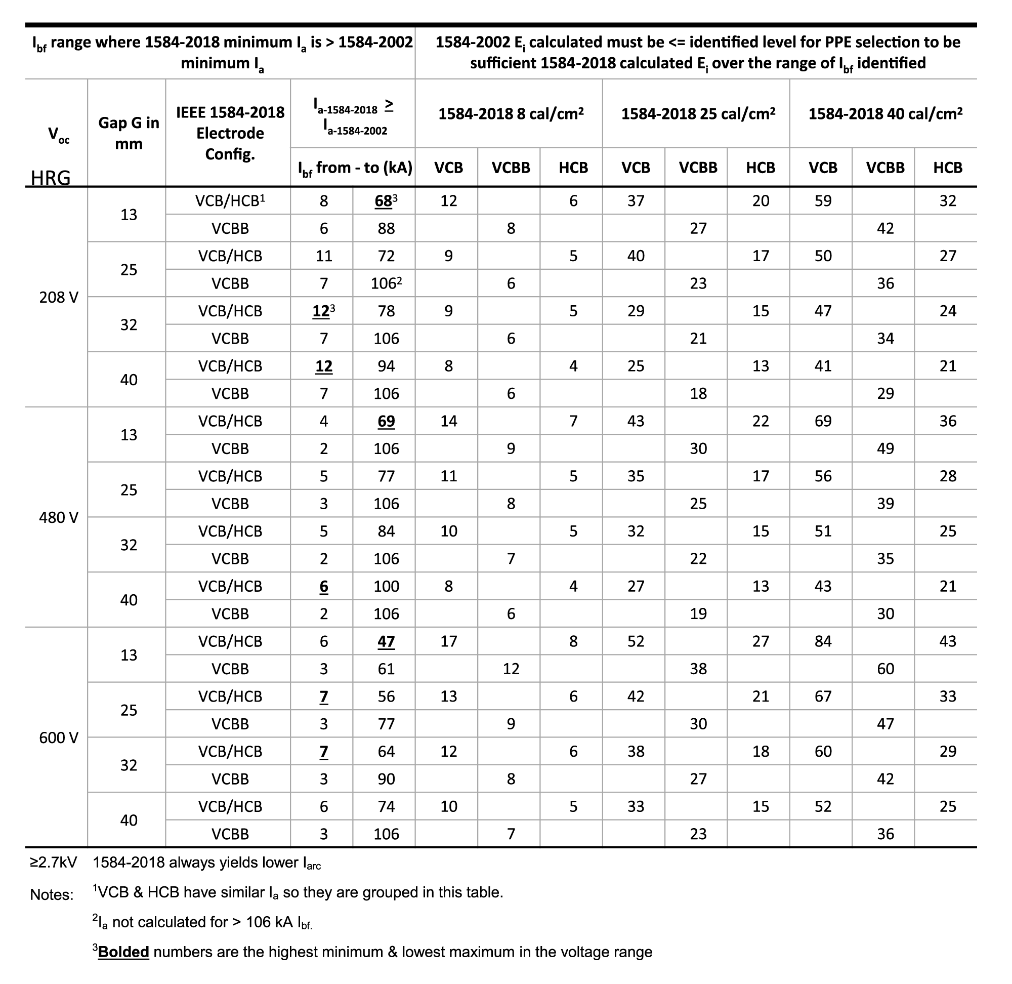

The results of plotting graphs for a series of comparative scenarios are summarized in the following tables.
HRG/Floating Systems
Calories/cm2 from 2002 study for HRG or ungrounded system. If PPE is = or higher rated than the arc rating identified at column top for identified conditions, then PPE should have higher arc rating than what a 2018 study would predict for the same identified conditions. Which include the same arcing gap, 18 inches working distance, standard box and electrode configuration of VCB in 2002 AF study and as identified in the column heading for the 2018 AF study.
Solidly Grounded Systems
Calories/cm2 from 2002 study for solidly grounded system. If PPE is = or > rated than the arc rating identified at column top for identified conditions then PPE should have higher arc rating than what a 2018 study would predict for the same identified conditions. Which include the same arcing gap, 18 inches working distance, standard box & electrode configuration of VCB in 2002 AF study & as identified in the column heading for the 2018 AF study.
Notes
≥2.7kV 1584-2018 always yields lower Ia
  1. VCB & HCB have similar Ia so they are grouped in this table.
  2. Ia not calculated for > 106 kA Ibf
  3. Bolded numbers are the highest minimum & lowest maximum in the voltage range
